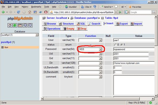

7 Verwaltung der Datenbank
For most people it is easier if they have a graphical front-end to MySQL; therefore you can also use phpMyAdmin (in this example under http://server1.example.com/phpmyadmin/) to administrate the pureftpd database.
Whenever you want to create a new user, you have to create an entry in the table ftpd so I will explain the columns of this table here:
ftpd Table:
  • User: The name of the virtual PureFTPd user (e.g. exampleuser).
  • status: 0 or 1. 0 means the account is disabled, the user cannot login.
  • Password: The password of the virtual user. Make sure you use MySQL’s MD5 function to save the password encrypted as an MD5 string:
