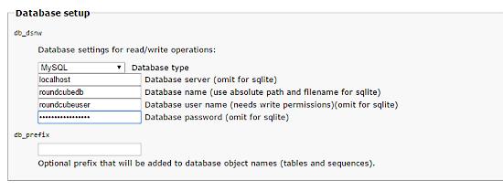

Nun werden wir RoundCube im Browser unter http://192.168.0.100/roundcubemail/installer installieren.
Erstellen Sie nun die Datei config.inc.php:
nano /usr/share/roundcubemail/config/config.inc.php
<?php /* Local configuration for Roundcube Webmail */ // ---------------------------------- // SQL DATABASE // ---------------------------------- // Database connection string (DSN) for read+write operations // Format (compatible with PEAR MDB2): db_provider://user:password@host/database // Currently supported db_providers: mysql, pgsql, sqlite, mssql, sqlsrv, oracle // For examples see http://pear.php.net/manual/en/package.database.mdb2.intro-dsn.php // NOTE: for SQLite use absolute path (Linux): 'sqlite:////full/path/to/sqlite.db?mode=0646' // or (Windows): 'sqlite:///C:/full/path/to/sqlite.db' $config['db_dsnw'] = 'mysql://roundcubeuser:roundcubepassword@localhost/roundcubedb'; // ---------------------------------- // IMAP // ---------------------------------- // The IMAP host chosen to perform the log-in. // Leave blank to show a textbox at login, give a list of hosts // to display a pulldown menu or set one host as string. // To use SSL/TLS connection, enter hostname with prefix ssl:// or tls:// // Supported replacement variables: // %n - hostname ($_SERVER['SERVER_NAME']) // %t - hostname without the first part // %d - domain (http hostname $_SERVER['HTTP_HOST'] without the first part) // %s - domain name after the '@' from e-mail address provided at login screen // For example %n = mail.domain.tld, %t = domain.tld // WARNING: After hostname change update of mail_host column in users table is // required to match old user data records with the new host. $config['default_host'] = 'localhost'; // provide an URL where a user can get support for this Roundcube installation // PLEASE DO NOT LINK TO THE ROUNDCUBE.NET WEBSITE HERE! $config['support_url'] = ''; // This key is used for encrypting purposes, like storing of imap password // in the session. For historical reasons it's called DES_key, but it's used // with any configured cipher_method (see below). $config['des_key'] = 'pb0UucO0eqjgvhrqYlFTBVjE'; // ---------------------------------- // PLUGINS // ---------------------------------- // List of active plugins (in plugins/ directory) $config['plugins'] = array(); // Set the spell checking engine. Possible values: // - 'googie' - the default (also used for connecting to Nox Spell Server, see 'spellcheck_uri' setting) // - 'pspell' - requires the PHP Pspell module and aspell installed // - 'enchant' - requires the PHP Enchant module // - 'atd' - install your own After the Deadline server or check with the people at http://www.afterthedeadline.com before using their API // Since Google shut down their public spell checking service, the default settings // connect to http://spell.roundcube.net which is a hosted service provided by Roundcube. // You can connect to any other googie-compliant service by setting 'spellcheck_uri' accordingly. $config['spellcheck_engine'] = 'pspell'; $config['enable_installer'] = true;
Dann drücken Sie „weiter“ im Web-Installationsprogramm. Auf der folgenden Seite drücken Sie auf die Schaltfläche „Datenbank initialisieren“.

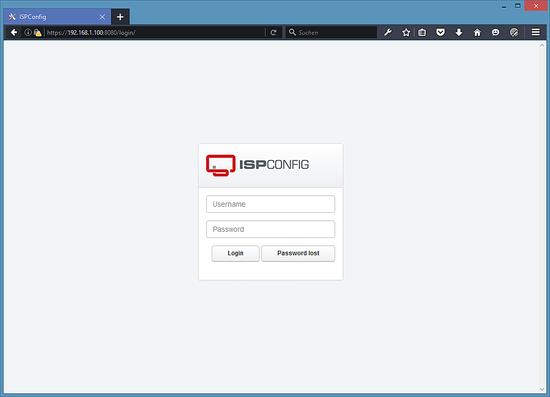

23 Erste ISPConfig-Anmeldung
Danach können Sie auf ISPConfig 3 unter http(s)://server1.example.com:8080/ oder http(s)://192.168.0.100:8080/ zugreifen (http oder https hängt davon ab, was Sie bei der Installation gewählt haben).
Melden Sie sich mit dem Benutzernamen admin und dem Passwort admin an (Sie sollten das Standardpasswort nach dem ersten Login ändern):
